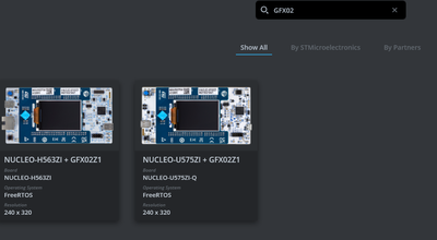

2025-10-27 8:48 AM
Hello @sesh ,
Unfortunately there is no TBS for that config but you can inspire from one of the boards starting from TouchGFX designer: NUCLEO-H563ZI or NUCLEO-U575ZI:
