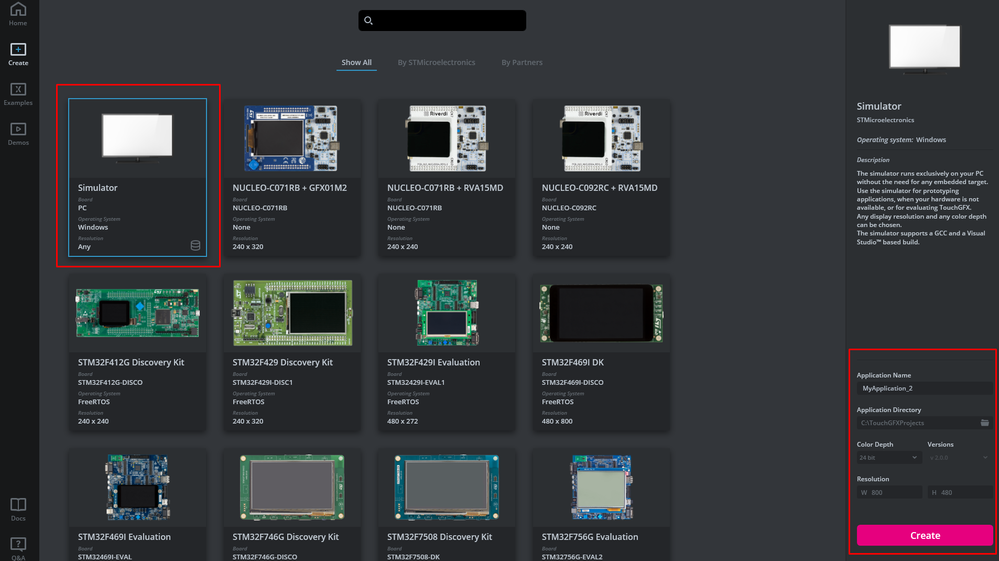

project path is default example path: c:\TouchGFXProjects\MyApplication_1\.
Also the project is empty application:

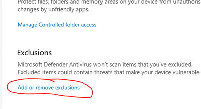

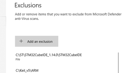

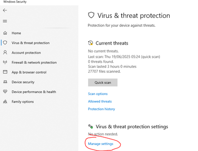

2025-06-24 12:20 AM
And did you try add project folder to this list ?
And add your folder
