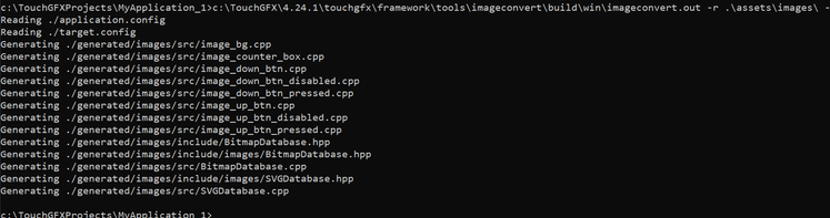

Try to generate assets separately
e.g. Images
Delete folder [.\generated\images] and in the folder where your .touchgfx project lives run this from command line:
c:\TouchGFX\4.24.1\touchgfx\framework\tools\imageconvert\build\win\imageconvert.out -r .\assets\images\ -w .\generated\images\
2025-06-23 2:16 AM

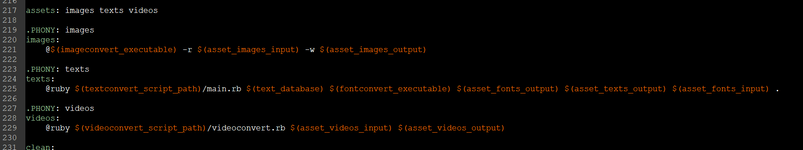

Do the same for texts and videos - have a look at ./generated\simulator\gcc\Makefile

Thank you for suggestions I tried all three commands as per you suggestion:
c:\TouchGFX\4.25.0\touchgfx\framework\tools\imageconvert\build\win\imageconvert.out -r .\assets\images\ -w .\generated\images\
c:\TouchGFX\4.25.0\env\MinGW\msys\1.0\Ruby30-x64\bin\ruby.exe c:\TouchGFX\4.25.0\touchgfx\framework\tools\textconvert\main.rb .\assets\texts\texts.xml c:\TouchGFX\4.25.0\touchgfx\framework\tools\fontconvert\build\win\fontconvert.out .\generated\fonts .\generated\texts .\assets\fonts .
c:\TouchGFX\4.25.0\env\MinGW\msys\1.0\Ruby30-x64\bin\ruby.exe c:\TouchGFX\4.25.0\touchgfx\framework\tools\videoconvert\videoconvert.rb .\assets\videos .\generated\videosEverything was generated fast in few seconds.
So there seems to be an issue before that calls.
2025-06-23 3:10 AM
Hm, would be useful to enable verbose mode somewhere, maybe in .touchgfx project. I tried VERBOSE=1 but not sure
"GenerateAssetsCommand": "make VERBOSE=1 -f simulator/gcc/Makefile assets -j8",Did you try assets generation in MSVS ?
