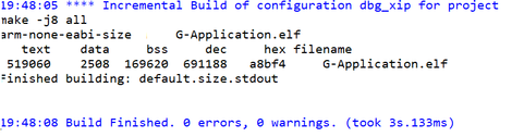

When you link you app what does console say about ROM/RAM usage

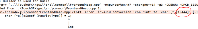

>> "i also did a test where i removed many existing screens and containers (effectivly lowering the overall memory footprint)"
This is the crutial point - Heap of Gfx is sizeof biggest screen/view. By removing screens you are surely lowering ROM footprint, but not necessarily RAM footprint.
To see Gfx Heap size, check sizeof 'MaxViewType' e.g. in FrontendHeap.cpp:
char (*oi)[sizeof (MaxViewType)] = 1;
I hope you find time to determine what was causing the crash. Are you able to run a simulation if it happens there ?
