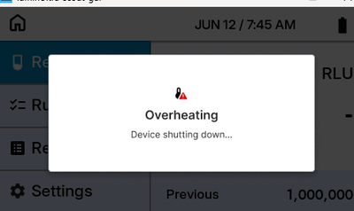

I need to trigger a modal in 15 different screens, like this:
I had a similar question on another post, and the solution works if I use buttons, but not if I send the notification from the model, which is what I need.
If I use a button like this the resulting screen is the one above.

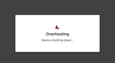

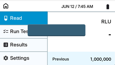

If I create an interaction on the screen, that when called changes the screen to the modal, this is what happens:
What I need is to call the interaction from the model, not to use a button. But the result is different than expected.
