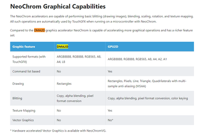

Sorry for my late reply. Here are the Supported formats (with TouchGFX) for the DMA2D:
You can find this table and more on this link: TouchGFX on NeoChrom/NeoChromVG | TouchGFX Documentation
Best Regards.
