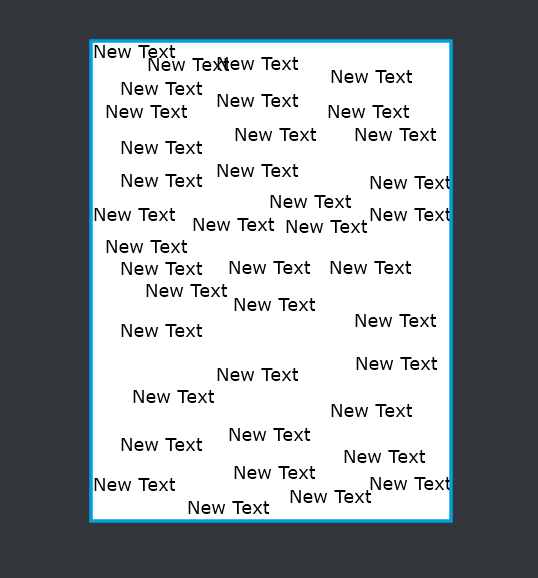

Im looking to add a page with multiple test boxes,as i need to update sensor readings to the screen. Originally i built this in custom containers as i would normally, but it kept crashing on creating on the new page. So i have worked back making the page more and more simple untill i found a threashold of it occuring when i have 38 default text boxes on the screen (see pic), the text boxes have no buffers allocated to them and this is on a fresh screen so no functions or code running.
if i lower the number of text boxes to 34 its fine.
is this a limitation of 4.20 ?

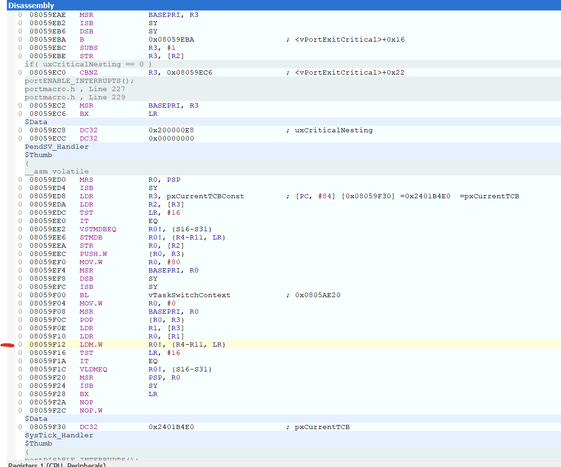

I've tried increasing the canvas buffer and rtos heap and task memory but nothing resolves this crash (HardFault exception), i've attached the memory address in the diassembler.

Im running an STM32H757 so i should have pleanty of RAM
I think i have managed to resolve this. I changed the following task buffer size. this was originally 1024. no changing it to 2048 i've not seen the crashes.
// frertos.c
uint32_t guiBuffer[2048]; // Increase buffer size for gui task
// Update thread definition for gui
osThreadStaticDef(gui, Gui_Task, osPriorityNormal, 0, 2048, guiBuffer, &guiControlBlock);

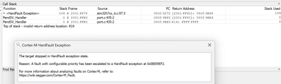

Hi @justin11 , what does function call stack say ?
2024-10-25 2:06 PM - edited 2024-10-25 2:21 PM
2024-10-25 2:18 PM
2024-10-25 2:20 PM
This is the call stack at the point it crashed

72 == sizeof ( touchgfx::TextArea )
72*34 = 2448 bytes
So you are creating them on heap. Does this happen if you add them from an array of lets say 50 TextArea ?
