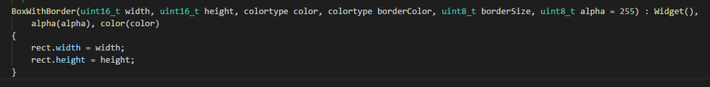

2019-05-23 9:59 AM
Looking in BoxWithBorder.hpp, it looks like the borderColor and borderSize members don't actually get set with the arguments in the constructor.
I would just call the setBorderSize() after construction. If you really need to set those in the constructor you could probably just add the missing parameters to the initializer list in this constructor but I would hesitate to change any of the touchgfx source without a really good reason.
