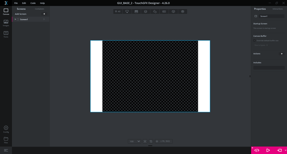

I am working with the STM32N6570-DK board and trying to display the live camera feed on a TouchGFX application.
I cannot find any ready-to-use example that integrates DCMIPP (Camera) and TouchGFX.
Current Situation:
TouchGFX Designer: I have created a UI with a transparent area in the center (Alpha = 0) to display the camera feed. (Please see the attached screenshot).
Cube IDE Firmware: I found the DCMIPP_ContinuousMode example and confirmed that it works fine independently. However, merging it into a TouchGFX project manually is quite difficult for me.
My Question:
Is there a simple, official example or Application Note demonstrating Camera Preview (maybe on Layer 0) + TouchGFX UI (maybe on Layer 1) for the STM32N6570-DK?
Since I am new to the STM32N6 series, a detailed, step-by-step explanation would be very helpful.
I would appreciate a quick guide or a GitHub link.
Thanks.
