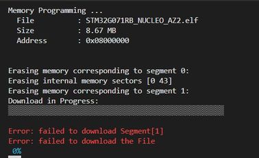

I've been struggling to flash a simple TouchGFX application through the STM32 VS Code extension. I am using the Nucleo-G071RB dev board with the GFX01M2 display board. My project was initially created using the TouchGFX designer, then generated the CMake project in CubeMX. In VS Code, I added the SPI_FLASH section in STM32G071RBTX_FLASH linker file, and the cmake/touchgfx sub directory in the CMakeLists. This allowed me to build the project with no errors. However, whenever I try to flash, I get the following:
I suspect this has something the do with the external flash. I am aware of an external loader file that you have to select in STM32CubeIDE, but I'm not too sure what would be the equivalent in VS Code.

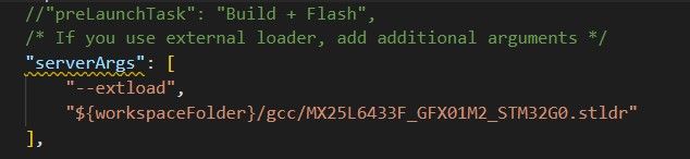

2025-06-12 9:51 AM
Hello @GaetanGodart,
Thank you for your reply. It seems like the flash issue happens right from the get-go. Without the SPI_FLASH, I get a flash overflow on the internal flash. And without the cmake/touchgfx in the CMakeLists, I get compile errors. Regarding the launch.json, I uncommented the external loader section:
This had no effect. I'm not sure if the external loader is being used or not.

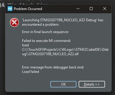

Regarding STM32CubeIDE, the code works fine using ST-Link GDB server and the external loader generated by touchGFX. However, not including the external loader, I get the following error:

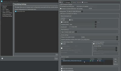

Regarding the STM32CubeIDE issue, it could be because you are missing the external loader in the configuration of the software. You can add it like that :
right click on your project => Properties => Run/Debug settings => External loaders
