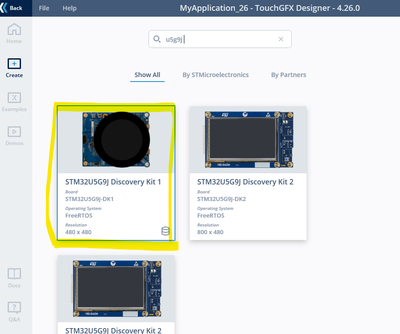

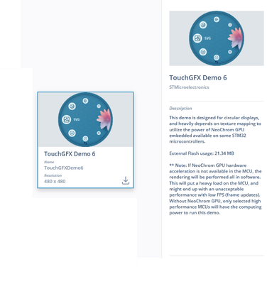

2025-11-05 6:41 AM
The exact same demo source is not publicly available, but a very similar demo is freely accessible in TouchGFX Designer:

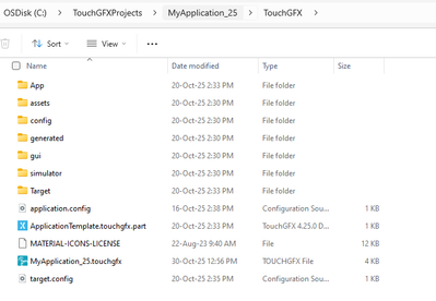

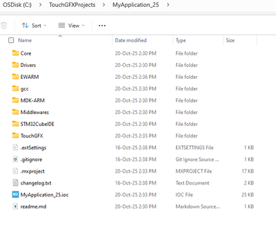

2025-10-30 5:17 AM
Hello @ashutoshtekriwal,
When you create the application in Designer, click the Files button located at the bottom left corner. A Windows File Explorer opens, displaying a path that ends with /TouchGFX. This folder is primarily used by the user interface (UI) and contains GUI code, generated GUI code, assets, and other related files.
However, for hardware code, navigate one level up. The folder you need to access is named after the application name you provided when creating your application.

2025-11-05 6:41 AM
