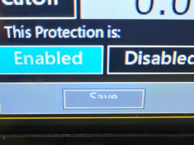

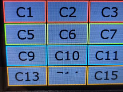

I have the same rendering problem with STM32H743ZIT6 and TouchGFX v4.22.1. I had the same problem with 4.21.4, as well. I am using a 480x272 display in RGB565 configuration. It doesn't matter if it is a plaint text or it is a label on a button, issue exists. In addition, the problem appears in different locations on the screen sporadically.
Disabling DCache solves the rendering issue but brings other problems with LWIP. So, it may be, I think, a workaround for the ones who don't need LWIP.
2024-03-18 4:17 AM
hi @NGune.1
You could try the following workaround:
1. put the frame buffer into a separate memory region
2. define a matching region in the MPU that disables the DCache for only that region
This will let you keep the DCache for other data (like the data used by LWIP) and still avoid rendering issues
