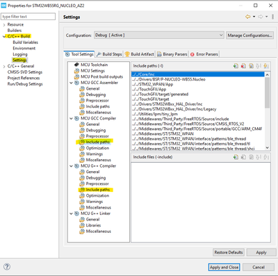

Hello @StefanoL ,
Could you describe what you did to include your libraries? Did you include them in here?
