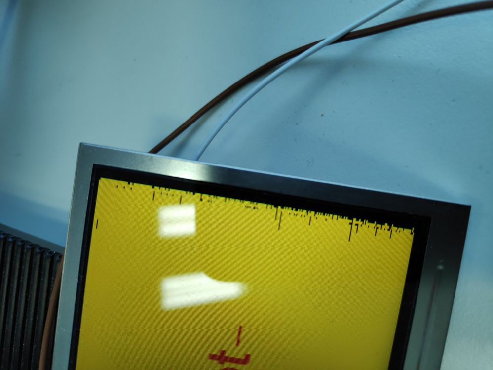

since i Updated to TouchGFX 4.21.0 (from 4.20.0) the LCD shows a visual artifact
it happens when rendering images in the L8_565 format (plain RBG_565 works) or text
i'm using a STM32 nucleo board with a STM32H7A3 processor
when i generated the code with CubeMX 6.6.1 and TouchGFX 4.20.0 it worked without artifacts
but after i updated to CubeMX 6.7.0 and TouchGFX 4.21.0 it started showing these artifacts:
example 1: this full screen image should have a solid yellow background, it is revealed using a wipe transition from black to the image. The wipe transition leaves black artifacts on the right edge (transition goes from left to right)

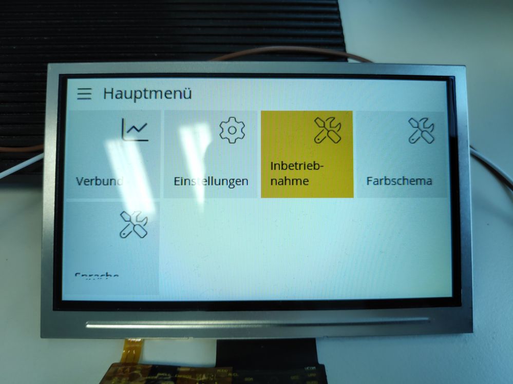

Example 2: the text on the last menu tile is sometimes cut in half, it should say "Sprache"

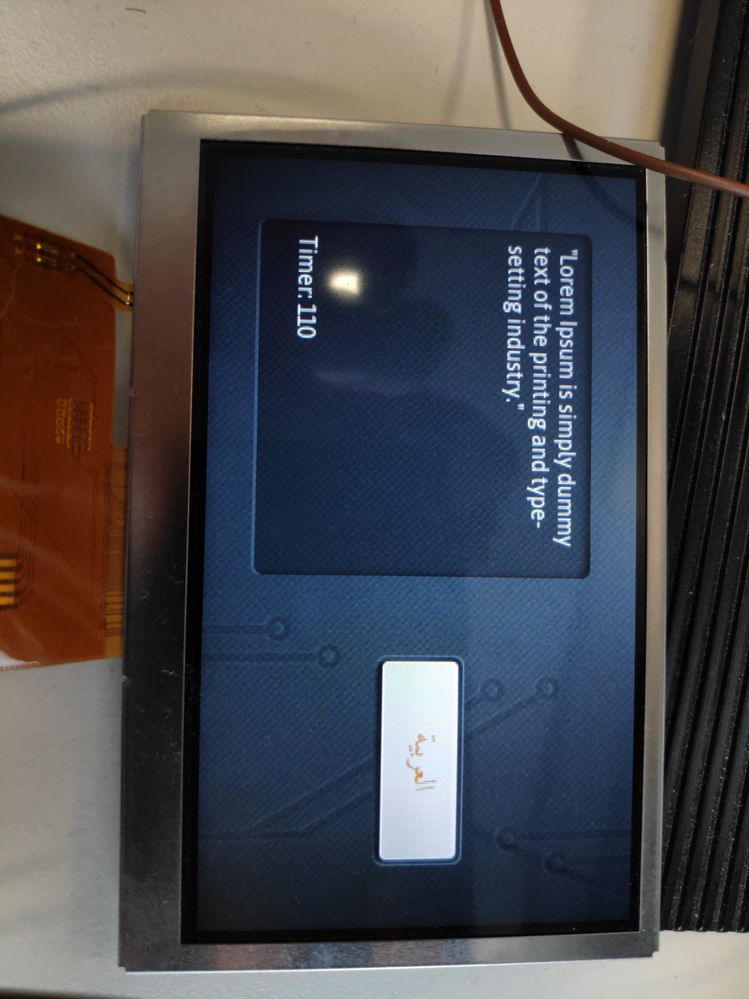

Photos of the example project:
sometimes the text is rendered correctly:

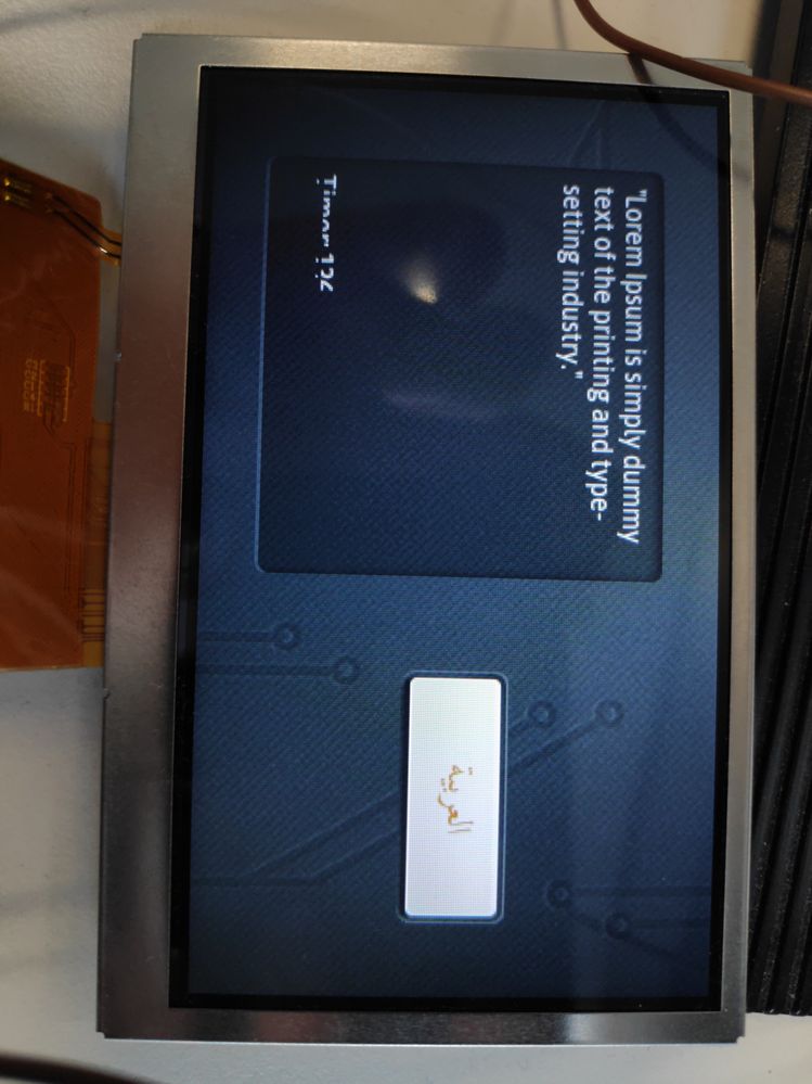

but sometimes the text is cut off:

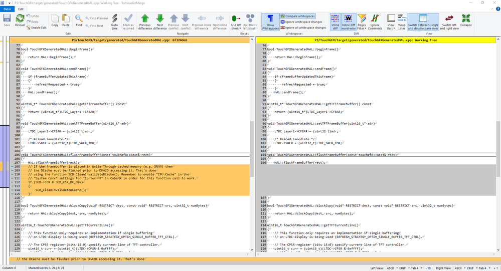

2023-05-30 4:31 AM - edited 2023-11-20 8:09 AM
i have now reproduced the bug on the STM32H750B-DK and have attached the project
and i've noticed that the bug only occurs, if the CPU data cache is enabled.
So i think it's a data synchronization issue between the DMA2D and the CPU
I've also noticed that a call to SCB_CleanInvalidateDCache() was deleted from TouchGFXGeneratedHAL when updating from 4.20 to 4.21:
this gives us two ways to avoid this issue:
