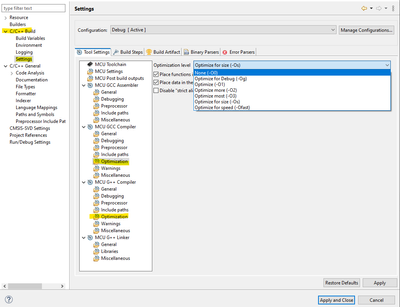

I can suggest you to compare the 2 different makefiles and see if something could explain the issue :
- STM32CubeIDE makefile in your STM32CubeIDE/Debug folder
- TouchGFX Makefile in gcc folder
You can also try to remove optimization for example and see if it helps.
