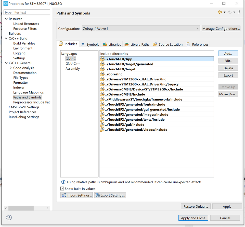

Hello @DHan.2 ,
Did you try to add LCD1bpp.hpp file reference in your project ?
This file is located at Middlewares>ST>touchgfx>framework>include>platform>driver>lcd.
In STM32CubeIDE, open your project properties and go to the "Path and Symbols" tab.
Then, click the add button and browse to the folder I mentioned above.
Please let me know if that solved your problem or not.
/Yoann
2022-08-16 12:52 AM
Thanks. Yoann.
I add the include path as you mentioned above... still same error.
