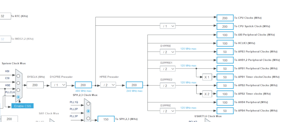

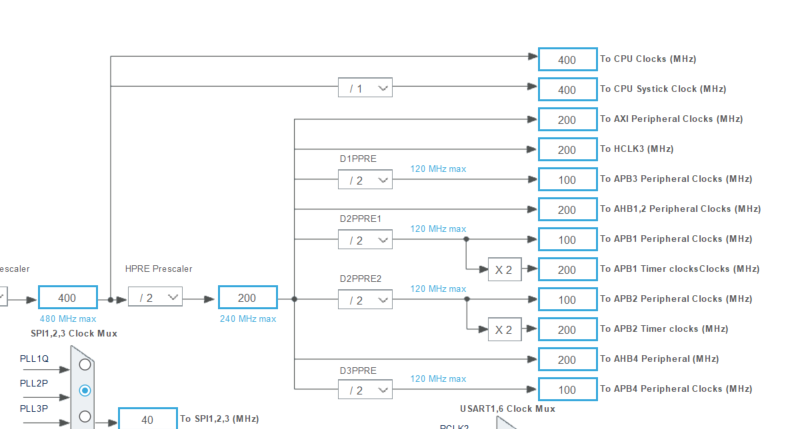

My old clock config:
My new tentative clock config:

>>> MCU is getting 70-80 degrees running at 400MHz without any animations on the LCD. Possible reason is the LCD and external flash communication...

>>> Ok. I found out that what happens is that when changing sysclk to 200MHz, the voltage range changes to 3. This implies a max frequency for AHB1,2 of 100MHz which means I have to reduce it.
