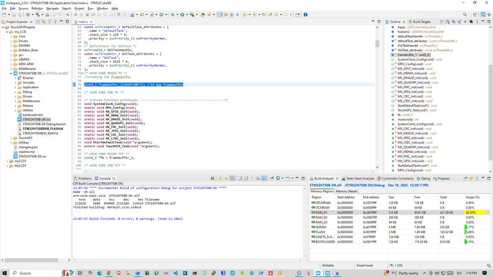

0) starting with the basic setup,
where the framebuffer is created, as it can be seen in the following picture, the RAM_D1 holds this buffer and its size is 300KB.
Indeed, the LTDC setup also follows these buffers' settings, see below for more...

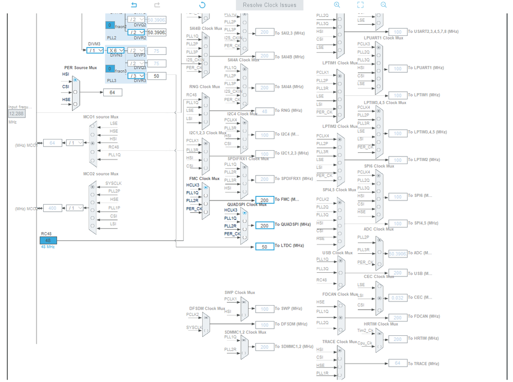

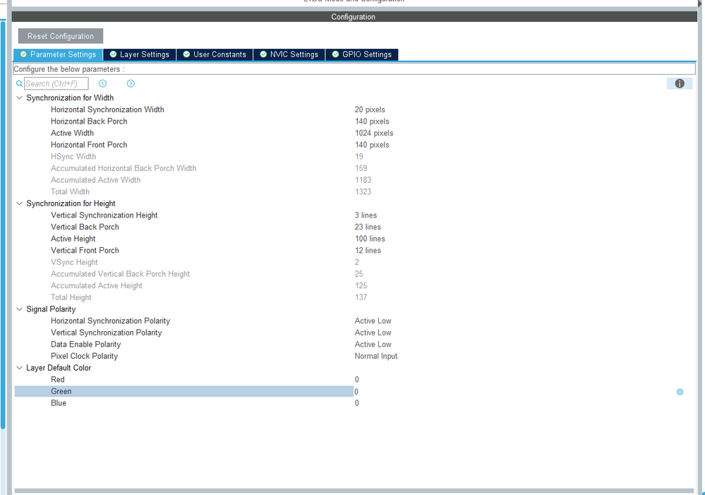

1) Not sure if the clocks are set for the display correctly,
the LCD manufacturer states that the pixel clock should be cca 50.7 MHz, using the following LTDC parameters' settings :
which raises the pixel clock to ≈ 50.7 MHz.
I am looking at the MX and Clock configuration is to 50 MHz at the "To LTDC (MHz) ", see the picture below, is this OK?
