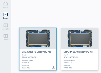

Hello @siddum.
I would recommend you to have a look at the STM32N6570-DK TBSs available in TouchGFX Designer for reference.
The TBSs are configured to use O-SPI flash for the TouchGFX assets. By default, the framebuffers are located in internal SRAM in the TBSs. However, it is easy to change this to PSRAM in the linker script since the PSRAM is already configured.
