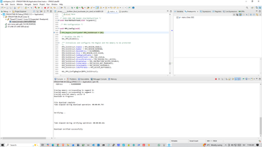

Trying to set up the custom display on the STM32H750B-DK dev board.

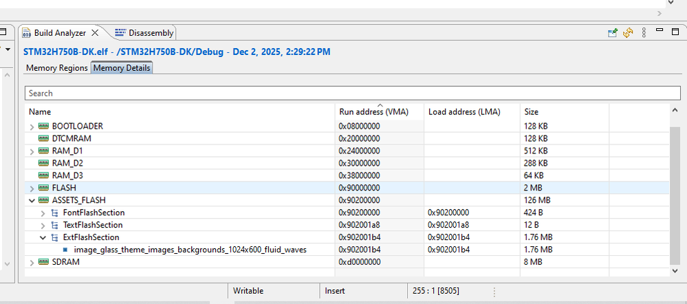

Interestingly, the display works via LTDC functions in Keil just fine... but I do not have much luck with the TouchGFX. For example, started with setting up the TBS in the Designer to avoid the complications of memory and other configurations (thanks to the ST support) and continuing in the CubeIDE where I have opened the .*.ioc file to update the MX configuration for the LTDC and TouchGFX... it compiles ok, I can opend the TouchGFX designer and "upload" the picture, for example, I can see the picture to be in the memory. See attached build memory analyzer.
However, when I run the application or debug, I cannot see the preview of the picture.
One of the ideas, as it is explained in the TouchGFX manual, namely Board bring up, would be to preview a simple framebuffer, not sure how easily that would be?
I am not sure how to tackle this problem, so any comments, ideas, or hints are more than welcome!
Best.
e memory

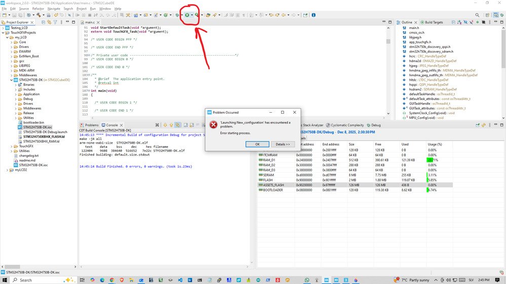

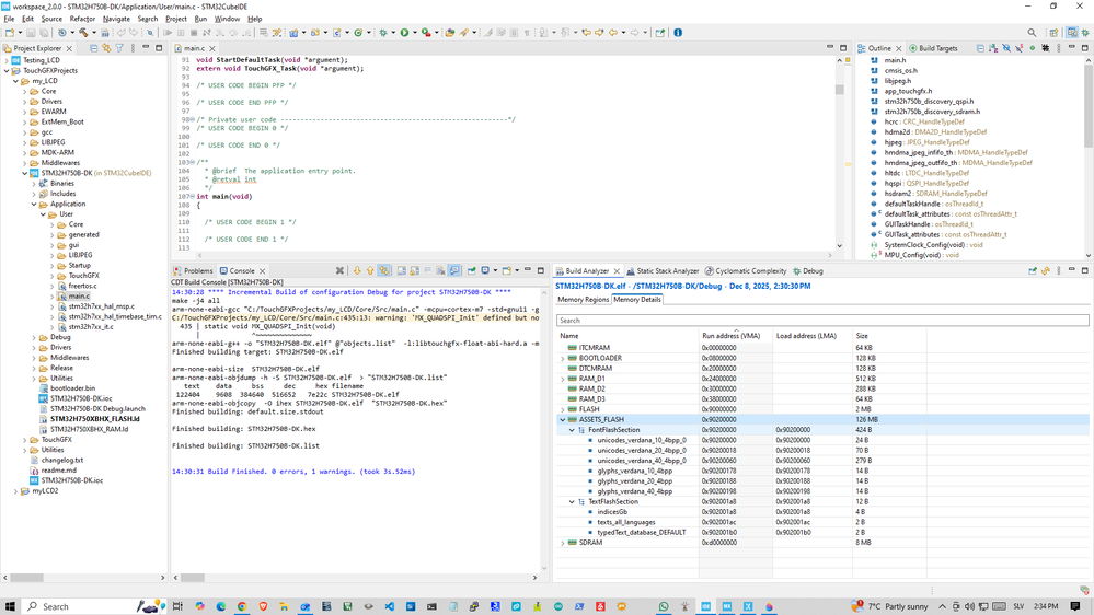

Deleted the pict. , inside the Touch GFX,
I cannot see the box, I cannot even "run the project", actually, how should I check I can see the box?

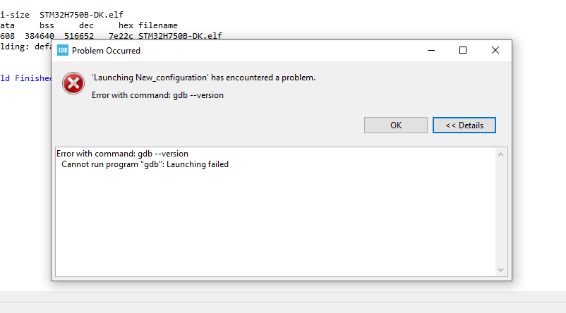

For example, if the "gren PLAY" icon is pressed, namely the Run... I get an error, see below:
Not sure about the map file? Where can I find it? It is not seen next to the *.ld exc. files...

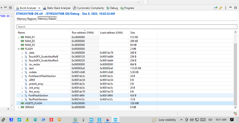

Checked the Build analyzer and I can see the following:
It seems that there is 436B in it ?
I guess the pict. is not there anymore...
Best.

1. Yes, these are the fonts in external flash that comes with the default typographies in your TouchGFX Application. Just to make sure, you should put them in internal flash. For that, edit your linker script to have the font flash section and text flash section:
FontFlashSection :
*(FontFlashSection FontFlashSection.*)
*(.gnu.linkonce.r.*)
. = ALIGN(0x4);
} >FLASH
TextFlashSection :
*(TextFlashSection TextFlashSection.*)
. = ALIGN(0x4);
} >FLASH

Re 1), corrected, compiles OK, and the "fonts" are in the internal flash...
Re 2), of course, I guess I should have used the *.hex file? BTW, where can the compiled *.hex file be found?
Re 3) Thank you!
Best.

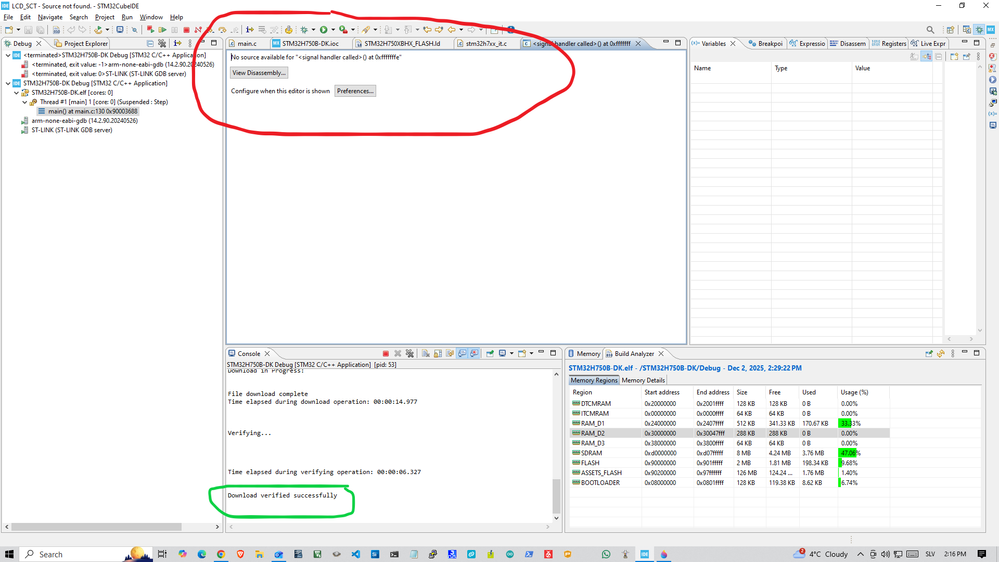

2025-12-09 1:16 AM - edited 2025-12-09 1:22 AM
Not sure what you mean by that, can you give me an example?
So far, this is the problem?
It does not even want to start the debugging process...

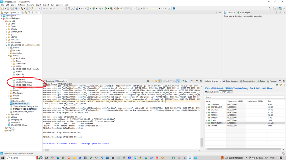

2025-12-09 1:42 AM - edited 2025-12-09 1:43 AM
Re: Downloading with the programmer:
Enabled the creation of the *.hex accordibng to this info https://community.st.com/t5/stm32cubeide-mcus/how-does-one-generate-a-hex-file-from-stm32cubeide/td-p/287131, appears in the "Debug" folder,
downloaded that file via the programmer, but nothing on the LCD, the LED on the top layer of the STM32H750b-dk is flashing (red, green)...
2025-12-09 2:26 AM
It looks like the debugging and downloading were solved;
When debugging is used, I land on this:
When Resume or F8 is pressed, I get the following on my LCD, first it kind of flashes, like 1 second
then it settles...
