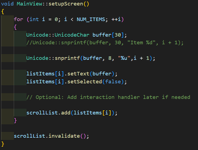

Here is one of the samples I am trying to do, though the content of the scroll list is more but just for our discussion and experiments created a sample.
Will Discuss on it further once you are available.
2025-06-16 1:21 AM
Hello @Shiv09 ,
In this example, you have 50 items and it does not crash like previously.
What is this code supposed to do?
Regards,
2025-06-16 9:55 PM
Hello @GaetanGodart ,
Yes this is new example I am trying to do experiments on.
Yes I need 50 Elements in the scrolllist, so added it.
In the above example I am trying to update the text in each element eg its name. hence have added it.

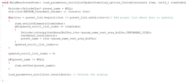

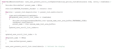

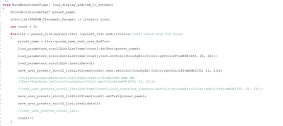

I share the snippets of the actual code which is crashing, hope it will be helpful.

Hello @Shiv09,
I will recommand you to debug your project and check the value of index and size, when it hits the assert.
No there's no way to search item in a list, you need to do your custom implementation.
