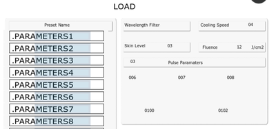

I am new to touchgfx and looking to implement something where a array of structure containing name and other parameters to display. I need to display parameters on selection of the names displayed.
I have a created a container and able to update the parameter names to the textarea of scrollist as in picture.
Now i need to implement a way where user can select any one Preset name and those corresponding parameters should load to the respective area. as in image attached.
Just let me know the way to do it will try out things as suggested.

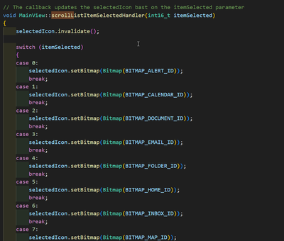

2025-05-19 5:32 AM
In the scrollList and scrollWheel example, we do update the image when we press one of the scrollList item.
I think this is this part of the code:
Basically, just use the setItemPressedCallback, create a handler for it and then a switch case.
This is also what we do in the tutorial I shared but in the tutorial we use a scrollWheel (this is basically the same).

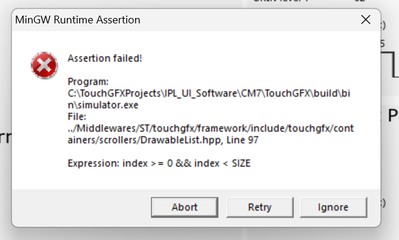

Now facing other problem with displaying the Elements in scroll list.
I need to have 50 elements to be stored and display in scroll list, for 6 elements not facing any problem but after adding more items to display getting this error.
Could you guide me on this?
2025-06-04 3:58 AM
Hello @Shiv09 ,
No problem! :)
It looks like it is trying to access an element that is "out of range" so not in the range 0 to SIZE.
Can you share the project so I can see if I can reproduce the issue?
Can you easily reproduce the issue?
Do you know from what amount of element the issue appears?
