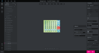

I created some text areas to display the file name, which comes from a character array provided by the user's input.
Below are the configuration settings for each text area.

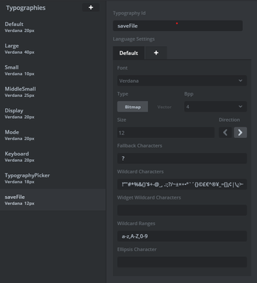

1.text area
2.Texts->Typographies

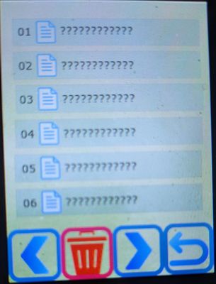

4.result
I’m sure that the const char *title is correct, but all the text areas display "???????????". Please help me fix this. Thanks in advance
