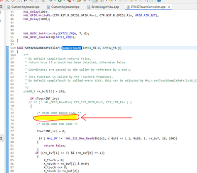

I developed a product,
but customer wants that if no touch detected in 10 seconds the device will go in home page.
I believe that the only way is to manage STM32TouchController.cpp in the point I have higlighted
Is it the best way ?
Thankyou for your patience.

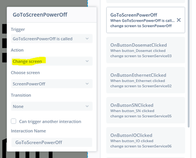

OK: but I deduce that
handleTickEvent
is executed at 60fps.
But to have
gotoHomeScreenNoTransition();
I have to add interaction like in the picture below, right ?
And there is a way to deduce what is the current display screen ? Because I have to go Home if I am in screens different from Home, Power on and Power off

The execution rate of handleTickEvent() is actually determined by how you tick the application. TouchGFX is designed to operate at 60 Hz by default, which is why I assumed 60 Hz in the code snippet.
You are correct that the generation of the screen transition code needs to be triggered, e.g. as shown in your screenshot.
