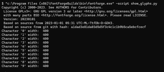

You can modify with a python script. FFPython.
CLI>> "c:\Program Files (x86)\FontForgeBuilds\bin\fontforge.exe" -script show_glyphs.pyimport fontforge
def print_width_digits ():
# Numbers '0' - '9' ie 48-58
for digit in range ( 48, 58 ):
glyph = font[digit] # Get glyph by character
if glyph.unicode != -1: # -1 means the glyph has no Unicode mapping
char = chr(glyph.unicode)
print ( f"Character '{char}' width: {glyph.width}" )
else:
print(f"Glyph name: {glyph.glyphname}, Unicode: None")
# Open the font file
font = fontforge.open("font.ttf") # Replace with your font file
else:

I have to note that it's not just the width of digits that make it monospaced for digits, but also the kerning. Kerning is distance to other characters. You don't want the unit or degree sign to move depending on the value of digits for instance. So kerning for digits needs to be fixed.
2026-01-09 4:07 AM
Yes, very true. This approach is a workaround rather than a perfect solution. I do not know, if there is a simple way to fix the kerning as well.
I imagine it could be used as a special typography for specific scenarios without adapting kerning. E.g. keeping the original font for inline digits, and using the modified font specifically for digit wildcards.
