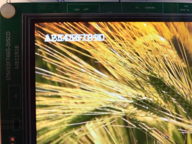

Unfortunately, it doesn't seems a size-related problem... as it affect the whole text and not only it's tail...
Attached you can see a screenshot of the screen... the two texts are "1234567890" and "ABCDEFGHIJ" and they overlap as if the 2nd one was just printed on top of the 1st one.

That's extremely peculiar. A call to invalidate() will force the rect that covers the textarea to be updated based on the contents of the TypedText.
Can you try making the code changes i posted?

Is this a problem on both Simulator and Target? You'd get this kind of behavior too if you did not have a background behind the text area, but it seems like you do.
