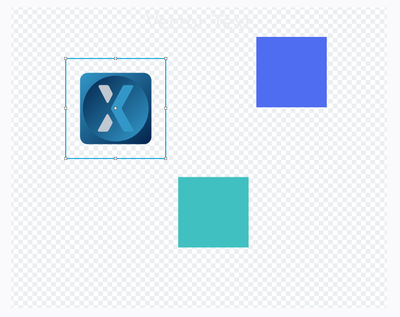

I have only one screen set up with some vector text, the default SVG image, and one SVG image that is a basic single-color rectangle. I also added a blue box widget to show that normal rendering is working fine. Here is how the screen looks in the Designer:
I have buttons mapped to rotate and scale the SVG images, and they are draggable. My finger is kind of in the way in the video, but you can still see the strange effects as I drag them around. The vector widgets do not appear to refresh themselves properly (seen when I drag them over each other). The text completely doesn't render properly.

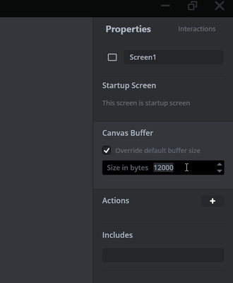

I increased the canvas buffer to 40,000 and it had no effect.
When using software vector rendering everything looks fine, but I get a much lower framerate (and it defeats the point of using it for me).
