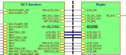

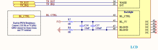

I checked the schematic, and I found that PE6 GPIO pin controls the backlight input of the LCD Module:
The PE6 GPIO can be programmed as PWM output of TIMER3's CHANNEL 4. So, all I had to do is to setup TIMER3 CHANNEL 4 in PWM mode and set the pulse width between 0% and 100% to turn off and on the backlight of the LCD Module. Configuring Timer 3 can be done in STM32CubeMX app.
