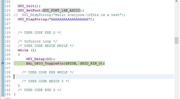

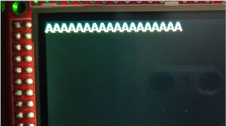

I'm working on STemWin532 library on STM32F103ZET6 bord in STM32CudeIDE. I could successfully configured LCD interface (The Controller is HX8325B and GUI runs on internal RAM) and insert some text on the screen (following image):

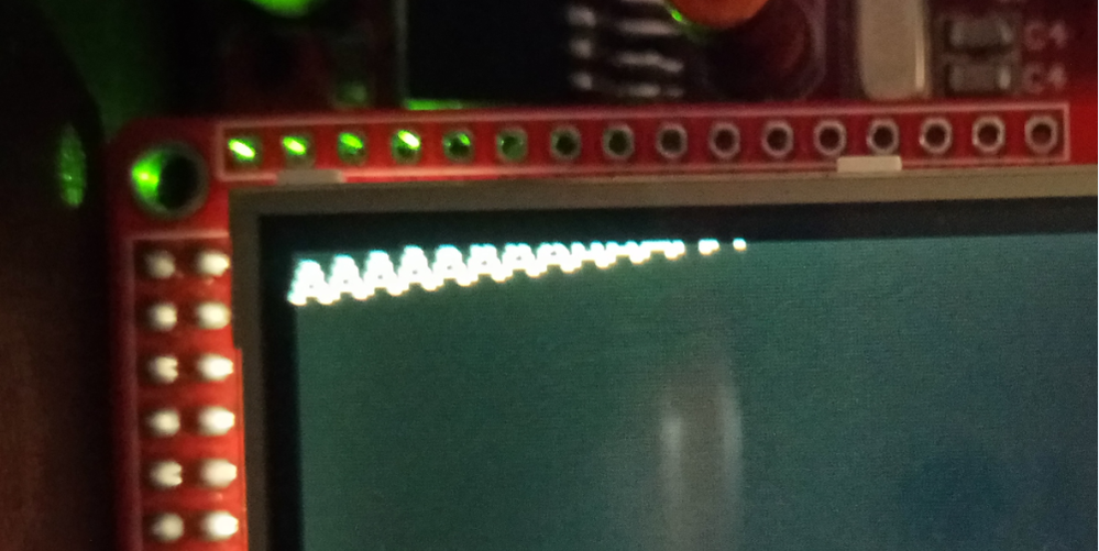

But when i use external SRAM as GUI memory result is very strange and interesting :). The text is driven out of the screen. The following picture shows the situation:
While the code is the same code that works correctly in the internal RAM of MCU. The only command that i changed is the following variable definition for GUI memory allocation:

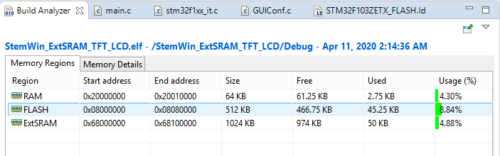

}Build Analyzer output of CudeIDE shows the memory usage:
