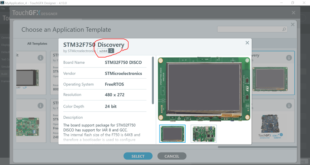

But what does "V3" mean in Application Template?
(TouchGFX 4.13.0)
Would you let me know it ?
