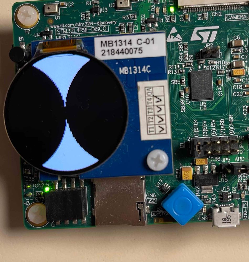

I am developing on STM32L4R9I-Disco, and I want to display ARGB8888 images on the round DSI display under the command of UART. For example, I send hex 'b2' to this board by uart, one image is displayed.
I have succeeded some parts, but the image is not well displayed (the attached picture).
Anyone knows what's the problem?
Thank you.

2020-12-01 10:41 AM
??? how is your problem ??? why 768-xsize offset
2020-12-02 1:42 AM
The image is tore into 2 parts, and it is inverted (the black in the photo)
768 - xsize: I use GFXMMU, it is the same with the example DSI_CmdMode_SingleBuffer in the firmware package.
Line offset = virtual buffer line width in pixels - image width in pixels.
2020-12-04 3:57 AM
Here is the solution: define the output of DAM2D as RGB888 or RGB565, not ARGB8888.
