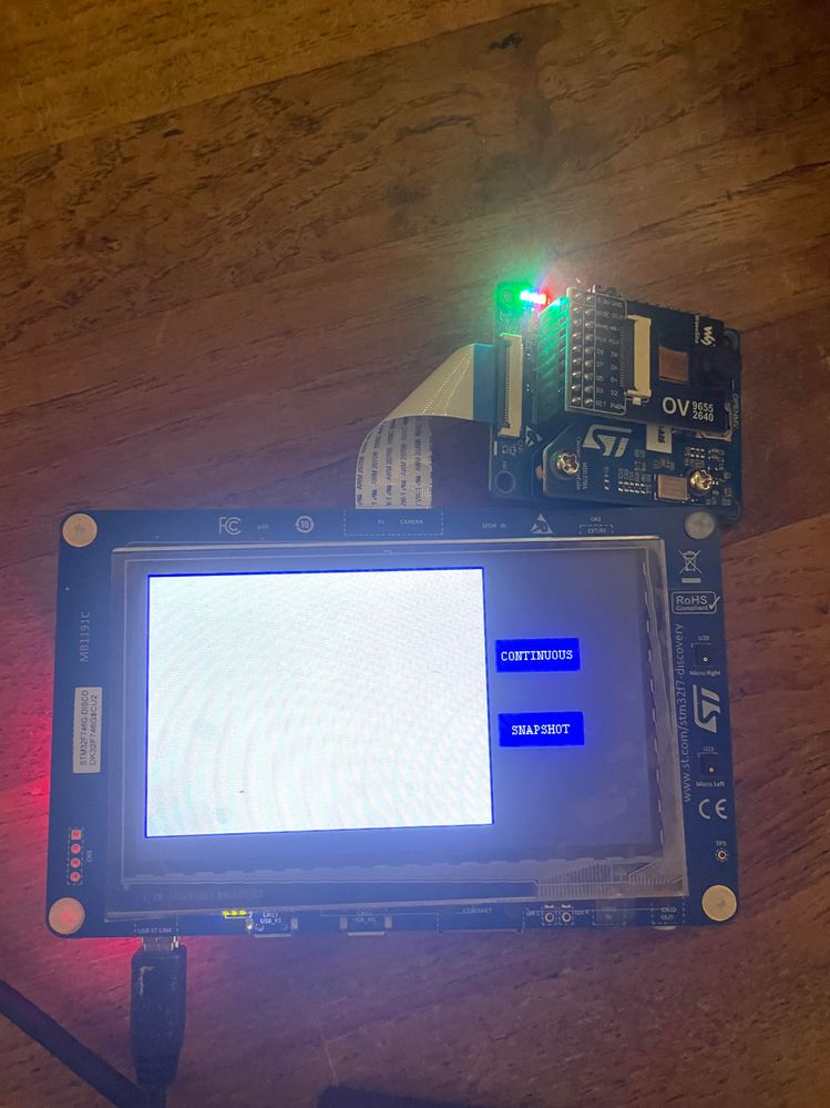

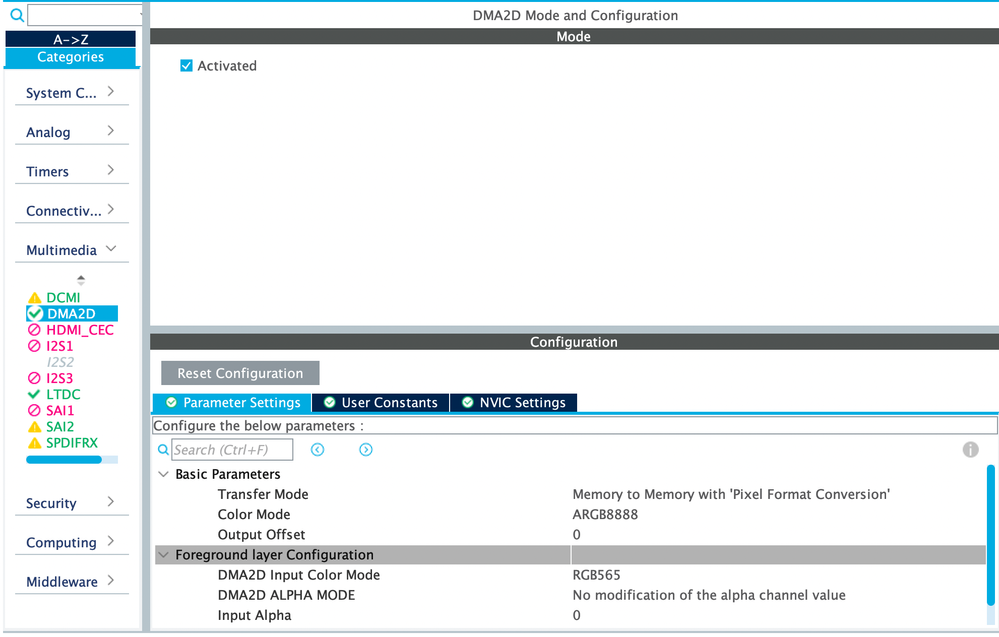

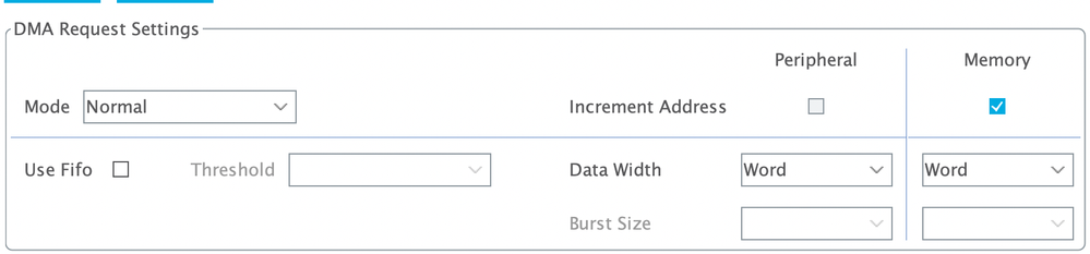

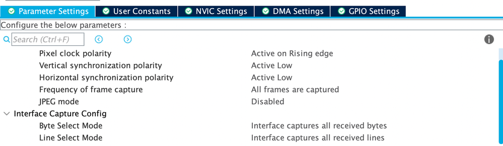

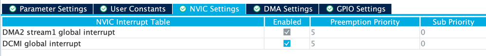

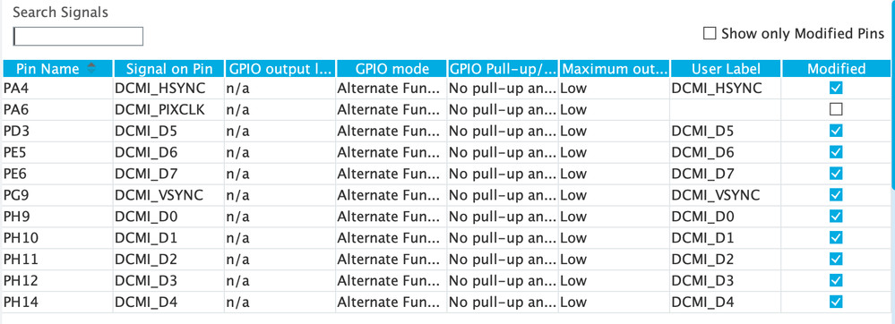

I have attached my code below along with the CubeMX configurations I am using for DCMI and DMA2. The photo below shows a white screen on the LCD where the camera feed should be displayed as the camera frame buffer is memset to 255 upon initialisation.

Hello @SolH and welcome to the Community :),
I checked the OV2640 datasheet camera and I found that the vertical synchronization polarity should be Active High. And you have configured the vertical synchronization polarity at active low.
Could you please change this configuration and let me know if the issue is solved.
For more details, I advise you to refer the AN5020 and precisely Hardware (or external) synchronization section.
Also, I recommend you to take a look at DCMI examples based on STM32CubeMX shared in AN5020 application note.
