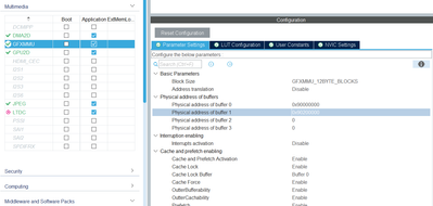

If you want, you could check the content of the framebuffer.
Their location are defined in STM32CubeMX under GFXMMU (among other places):

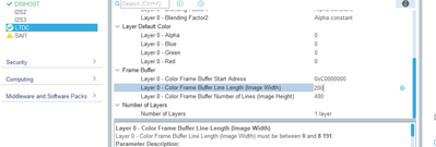

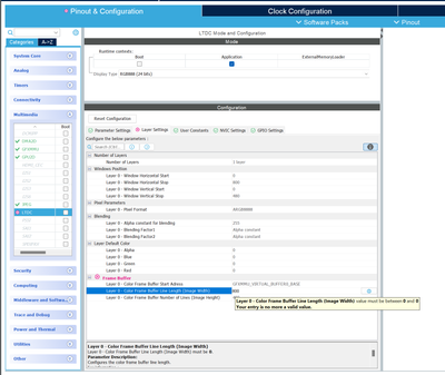

Meanwhile, opening the project on CubeMX I find the following error (error I find without having modified anything) see image "error" below.

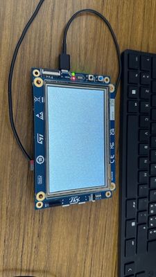

Once I fixed the error in image 2 via tutorial on known problems the screen appears to me as in image 3.

The width cannot be between 0 and 0, I think the version of STM32CubeMX you are using is incompatible.

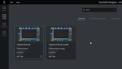

Have you tried to open TouchGFX Designer, create a new project, select the STM32H7S7-dk board in 24 bpp, flash and run from TouchGFX Designer?

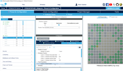

Your version of STM32CubeMX seems to not be the latest based on its looks.
Here is my STM32CubeMX (notice that the image width is between 0 and 8191) :

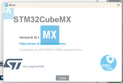

This is my version of CubeMX. I literally just re-downloaded the latest version on ST website and the error seems to be persistent.

I opened the project with the new version of TouchGFX (STM32H7S8-DK 24BPP).
