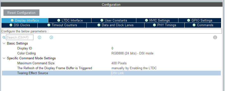

First, since you should now be getting TE signals on the bus rather than on a GPIO, set that under DSIHOST in CubeMX:

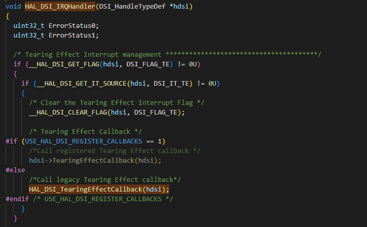

Now,when your DSI interrupt fires, it should be able to determine if a TE signal has been received:

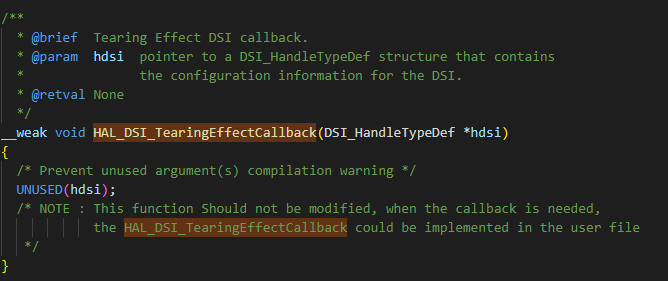

HAL_DSI_TearingEffectCallback() is weak, so you can define that yourself, which it seems from what you write is already done in TouchGFXHAL.
Are you still running adapted command mode, or are you in video mode?

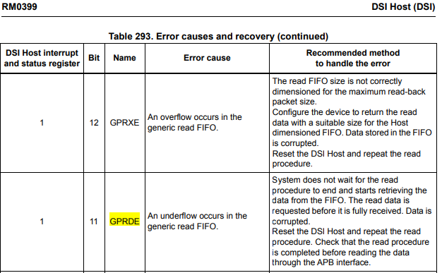

Interestingly, as soon as I call DSI_Start, the GPRDE bit is set in the DSI ISR1 register. Could this be an indicator for something? I also get constant LTDC interrupts with no flags in the LTDC ISR, so I assume this is cause by GPRDE.

The reference manual for H747 has this detail about the GPRDE bit:
In the original TouchGFX project, the LTDC is turned off when the DSI_Start command is called. It may lead to some undefined behaviour if the DSI is in the middle of a transfer when the DSI host starts up, so I would try to call
You might also have noticed that there is a 1 ms delay in the original HAL_DSI_EndOfRefreshCallback. I do not actually know why it is there, but I do know that the whole thing stops working if it is removed. My guess is that it ensures that the DSI bus or LTDC is ready for the modification that will happen because of the half-screen thing, so you could also just try to add a delay before starting the DSI host.

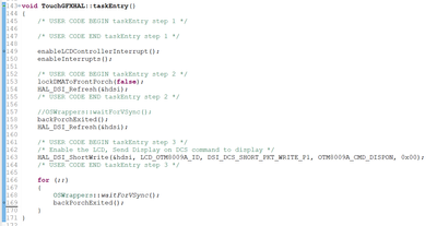

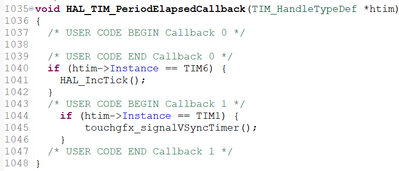

I've made progress, but still no complete working solution. I'm now using a timer to trigger vsync every 20ms from main:
When my code launches, the first framebuffer is written to the LCD. This is done by forcing a DSI Refresh from TouchGFXHAL::taskEntry(). The refresh that writes to the screen is on line 154.
This is fine, so long as my display is static. We get through backPorchExited() and go into the infinite loop, checking for vsync - although nothing ever actually changes in the framebuffer as there's nothing new to display.
If the framebuffer needs to be updated, either through user code in the view or putting an animated image in the display, the first refresh draws the initial framebuffer, but backPorchExited() never returns, it gets stuck on Model::Tick().

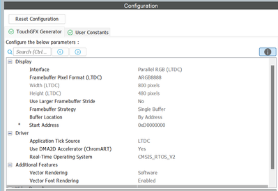

I have to assume that there is an issue with the updating of the framebuffer. Its address is allocated in CubeMX - does this need manually setting in TouchGFXHAL::initialize()?

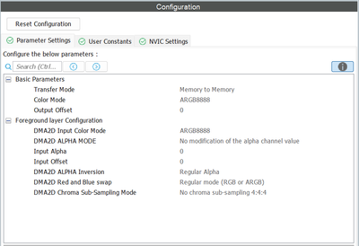

And DMA2D is configured with a matching format

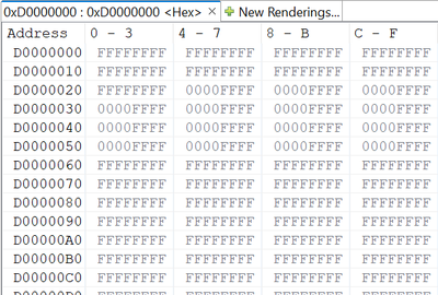

We're using external SRAM here, but FMC is configured and correctly as I can see the framebuffer in the memory monitor

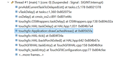

The stack trace when the task hangs is as follows

2024-11-14 4:22 AM
One thing that could lead to the tick method hanging is trying to measure MCU usage but not having the correct hooks in the OS to support this.
Do you have a call to enableMCULoadCalculation(true) somewhere? I believe removing that (or setting it to false in TouchGFXHAL::initialize()) would solve the problem so TouchGFX can execute.
I would advise using double buffers if you have space for that in RAM. In general, it is easier to have their address set by allocation than by manual address.
If set to by allocation, you can define what sector they go in with the linker script, you can see how that is handled for your particular compiler in most of the board setups that ship with the TouchGFX designer.
As you set it by address, it will be placed at that address.
You can see what the start address of the currently active framebuffer is in the LTDC->CFBAR register.
