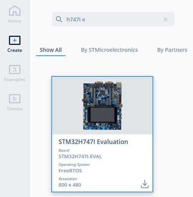

Which example project are you trying to run?
Could you test the TBS for STM32H747I-EVAL available in TouchGFX Designer? I believe this project should also work for STM32H757I-EVAL.

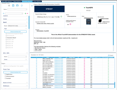

In STMCube32IDE, I followed these steps:
Is there something I missed or did wrong?

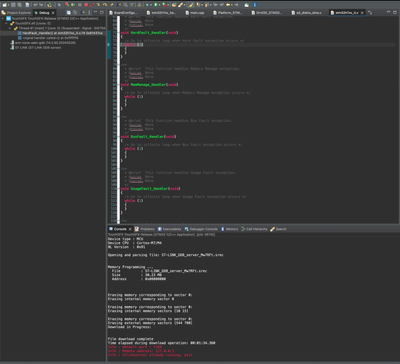

I've tried going into compiler options and compile with -g and -Og (to enable debugging and disable speed optimisation) but it made no difference. I can at least see the HardFault() after adding debug symbols (-g). Below is a screengrab of where it gets stuck in HardFault, and the call stack does not help me much.

2026-02-09 3:55 AM
Thanks for your response. It is a pity that I do not know what was wrong with the first project, but the one from TouchGFX worked, and did not generate HardFault.
