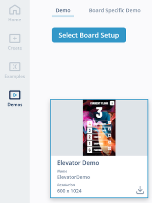

For reference, you can have a look at the Elevator Demo available in TouchGFX Designer.
A drag threshold is implemented in the main screen. I have inserted the relevant code below.
