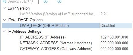

2. Regarding the netmask issue, in CubeMX configuration, after typing the netmask, make sure to press Enter so the value change takes effect. If it still didn't work, change it manually in lwip.c.
I didn’t need to change anything else. Please let me know if this resolves the problem, as I tested it on my side and it worked.
