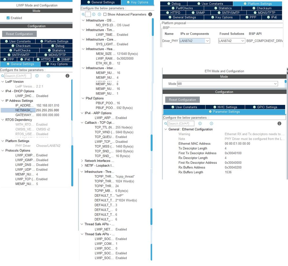

2026-04-03 7:09 AM
still the
>ping 192.168.1.10 -t
Pinging 192.168.1.10 with 32 bytes of data:
Request timed out.
Request timed out.
Request timed out.
Request timed out.
Request timed out. Please note the CubeMX config. thank you for your patience
2026-04-03 8:35 AM
Hello @ksale.1,
After regenerating the project, have you re-added the following linker file configuration?
.lwip_sec (NOLOAD) :
. = ABSOLUTE(0x30040000);
*(.RxDecripSection)
. = ABSOLUTE(0x30040100);
*(.TxDecripSection)
. = ABSOLUTE(0x30040200);
*(.Rx_PoolSection)
} >RAM_D2
Best regards,
