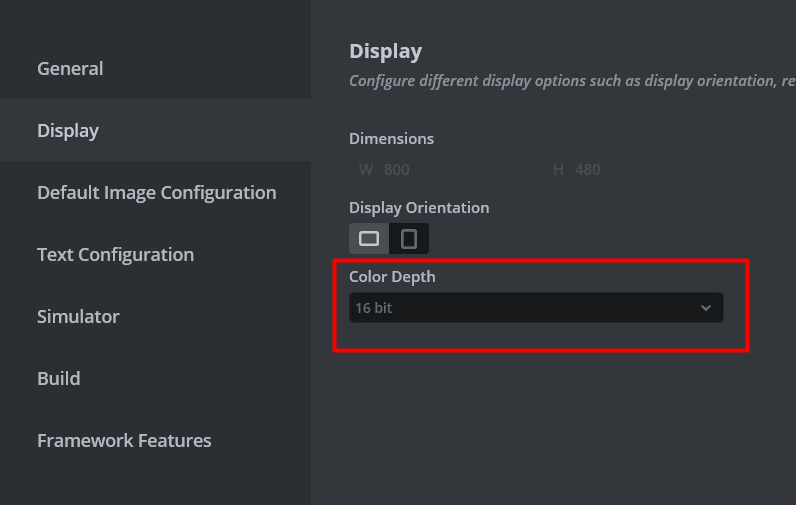

I have a stm32h747i-disco board. When I create a touchGFX project by using touchGFX designer template, it works perfectly. Its color depth is 24-bit and when I change color depth to 16-bit(RGB565), it fails.

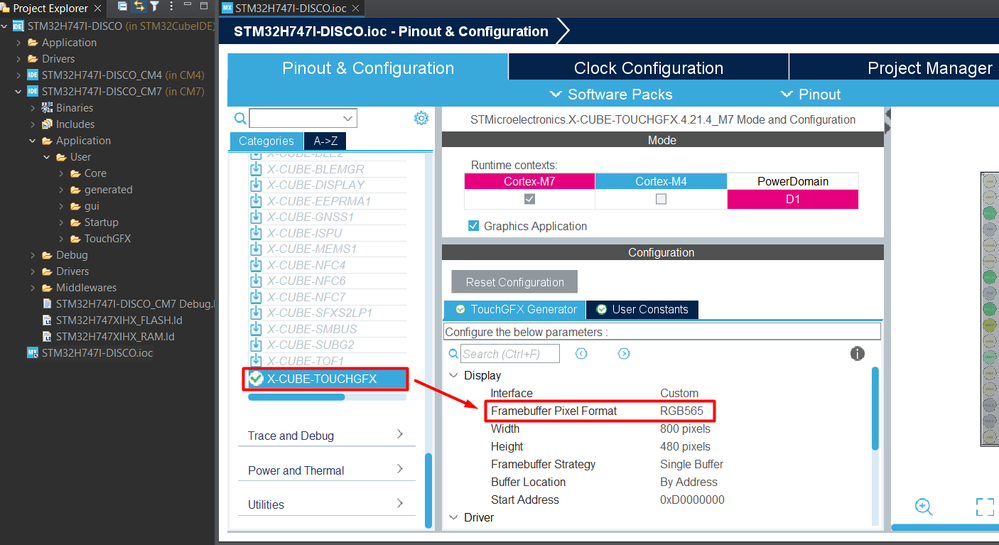

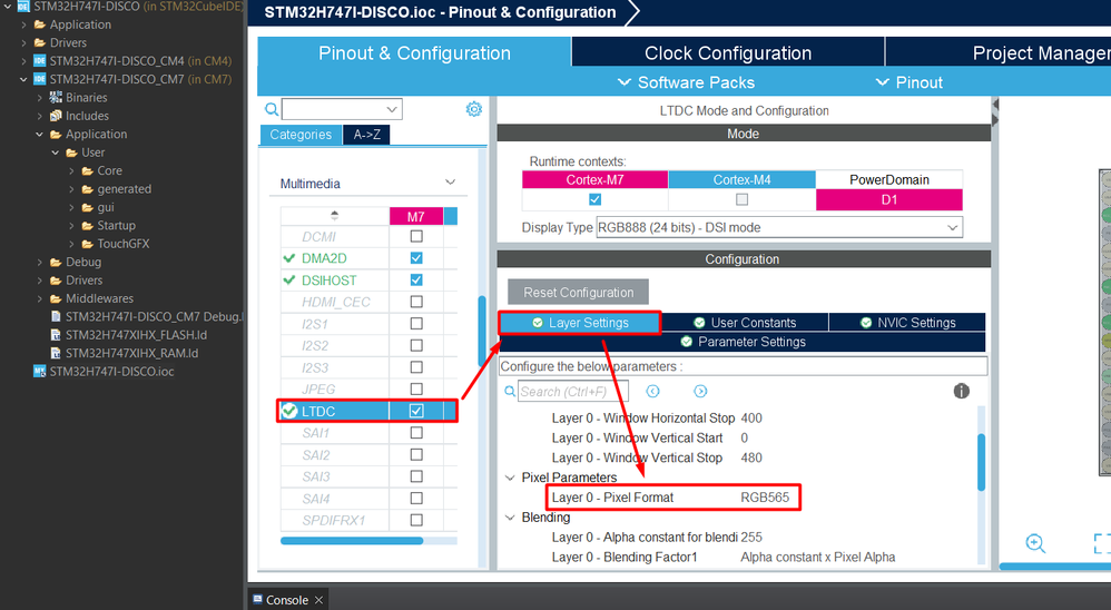

To change color depth to 16-bit, firstly I am changing Framebuffer Pixel Format section to RGB565 like in the below:

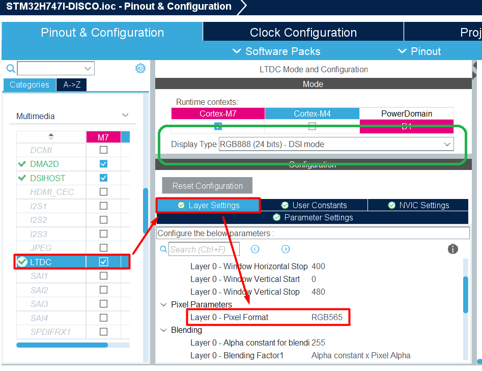

Then I am changing the Layer 0 - Pixel Format section to RGB565 like in the below:
Before pressing to cubeMX save button, I am deleting target folder. After that, pressing cubeMX save button. Ref: https://community.st.com/t5/stm32-mcus-touch-gfx-and-gui/8-bpp-color-palette/m-p/221627
Later, I am opening touchGFX project and as you can see it is 16-bit now.

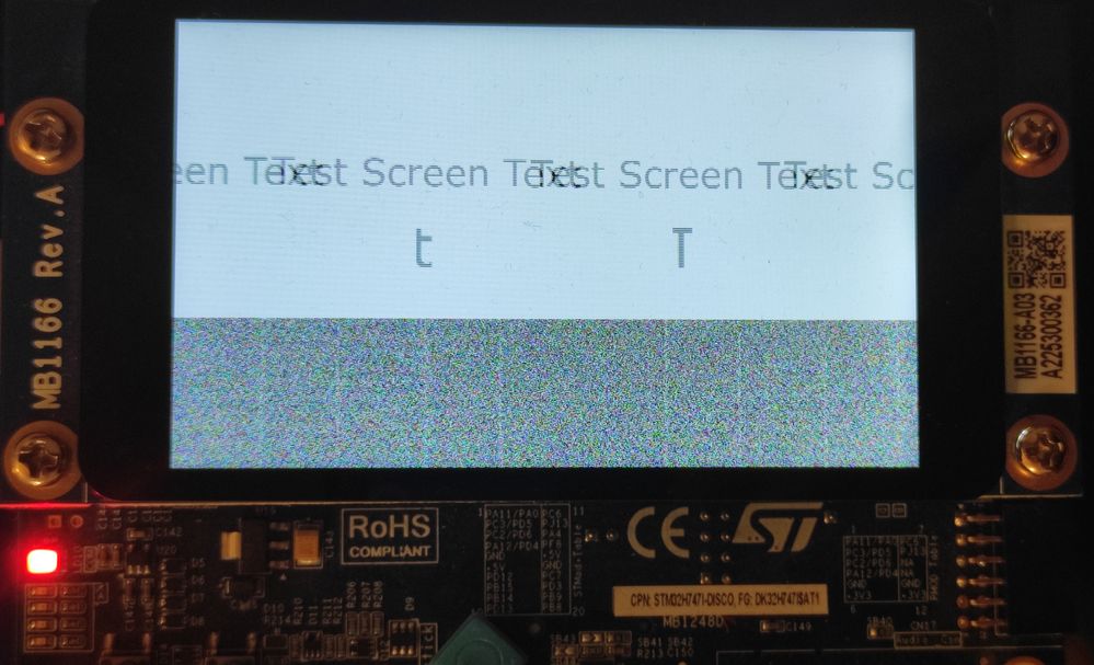

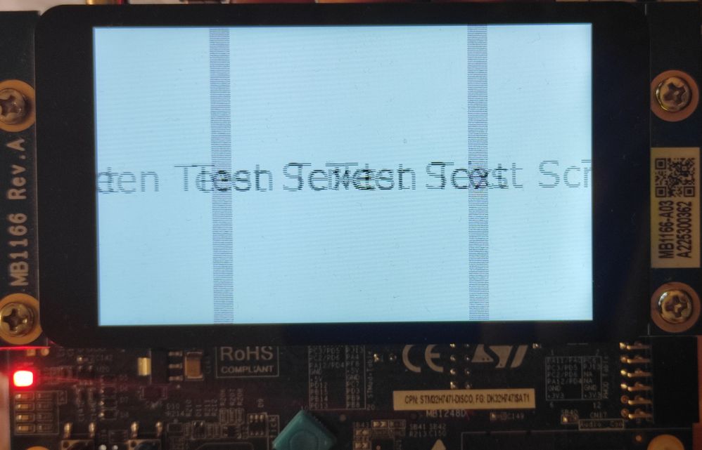

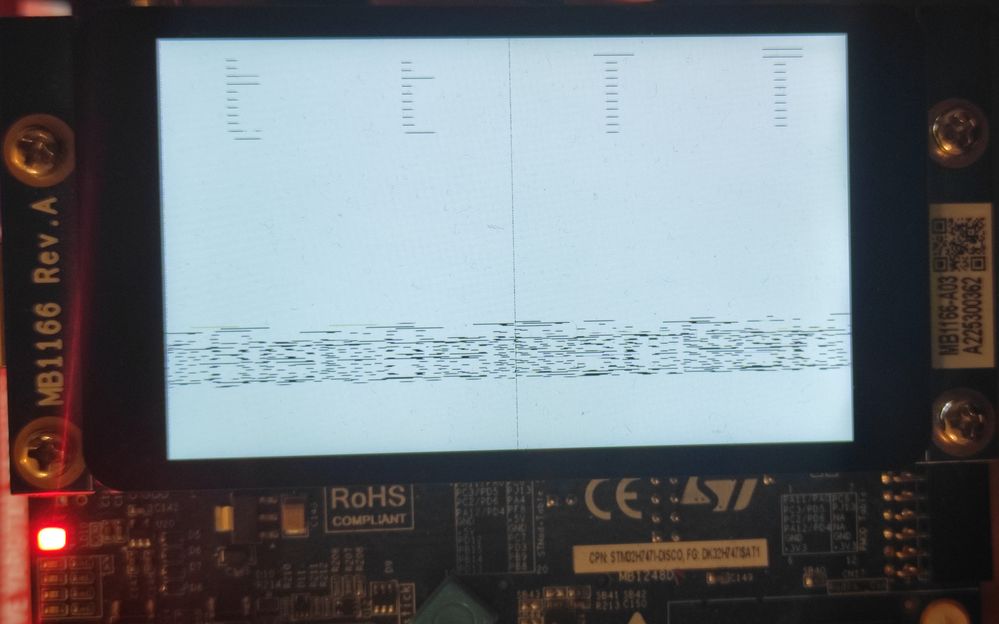

Then I am pressing "generate code" button and finally, i'm downloading new 16-bit project to stm32h747-i disco but it shows me this screen when I try to use 16-bit color depth. It fails.

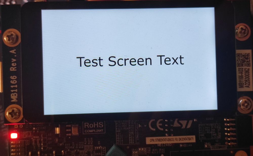

However, when i use 24-bit color depth, it shows me this screen as expected and works without any problem!!!
How can I use STM32H747I-DISCO development board with 16-bit color depth? What am I missing? What should I do? Thank you for all answers!

Fix DSI transport mode so data funnelled from LTDC appropriately. The display controller (on the screen/panel itself) also needs to expect the bit, byte, and lanes in the mode you're pushing over the wires.
2023-12-26 11:51 AM
Settings need to be coherent end-to-end. All of them..
So double check DSIHOST, LTDC, and Panel itself all have common expectations for data from the frame buffer.

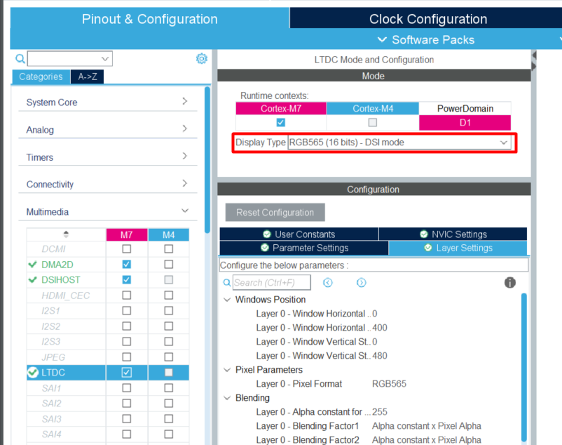

As your suggestion, I changed Display Type to RGB656.

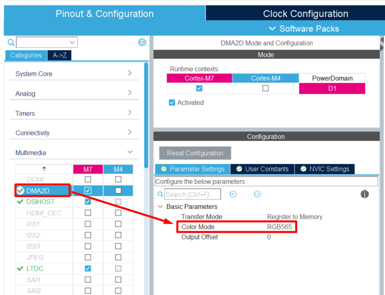

Then I changed DMA2D Color Code to RGB565.
Unfortunately it didn't work.

1-) TouchGFX Framebuffer Pixel Format to RGB565
2-) Layer 0 Pixel Format to RGB565
3-) Display Type to RGB565
4-) DMA2D Color Mode to RGB565

TouchGFX your point 1 and 2 must equal. Points 3,4 is irelevant . Point 3 can be used to speed up framerate.
But primary you need understand , that change somethink in MX dont reconfigure your display.
BSP driver code for display send commands to LCD controller before start show image and here you need setup equal as point 3.

Unfortunately, it didn't work. Am I missing something?
