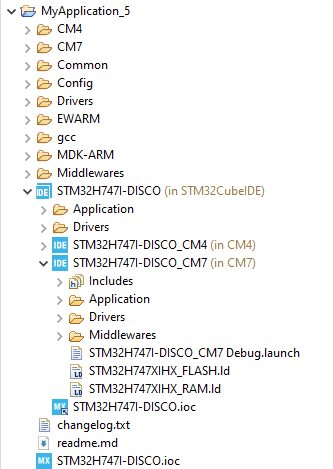

I am currently working on a project using TouchGFX, Ethernet an LwIP on a STM32H745I board and I was wondering if anyone has encountered a similar issue.
I am using :
I generated a project with TouchGFX Designer, and imported it on CubeIDE.
Then, I opened the .ioc file for adding the features of Ethernet and LwIP.
After generating the code, it seems that I cannot compile it because "lwip.h" is nowhere to be found, eventhough I can do "open declaration" and it opens a file from the upper folders. Here is a look at the project folders :
There is a Middlewares folder in the upper part but there is no Middlewares folder in the lower part. I tried to generate a project with the H747 board and the Middlewares folder is generated along with other folders :
Has anyone encountered this? Is it meant to be used that way?

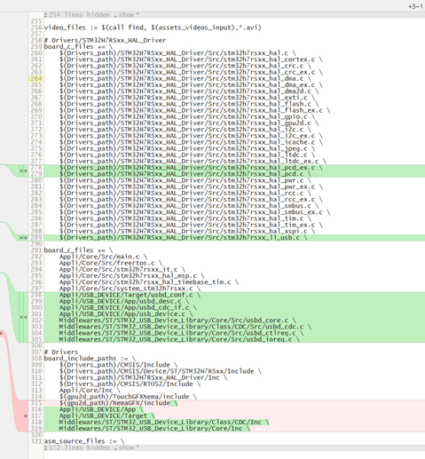

Hi
I had similar problem when I was trying to add USB feature from CubeIDE, while project was created using TouchGFX. Everything was compiled from TouchGFX tool. On my side, adding relative path to directories with required header files and relative path to source files in makefile_appli file (in gcc directory) resolved all compilation errors.
Below screenshot with makefile_appli changes:
