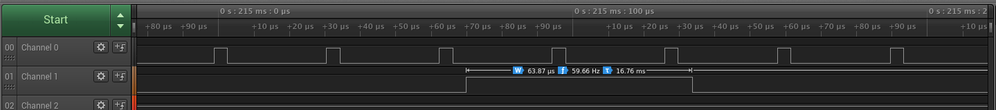

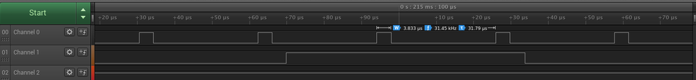

I analyzed the output of the PWM using my logic analyzer and thats the output for vsync and hsync:
As you can see, it's exactly as it should be. So, I have a VGA breakout connector and connected all the GNDs and the outer shield together. I also connected GND, hsync and vsync from my STM32 to it but my monitor still won't get a clear signal. I even tried reversing the polarity of the sync signals and nothing works. Using a 22 Ohm resistor also won't work.
