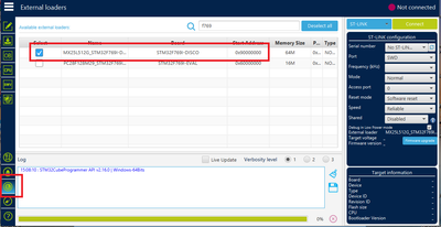

Did you enable the QSPI flash loader when you uploaded the hex file with the CubeProgrammer?
