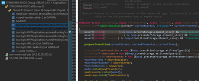

I have 4 screens in my application and I want to change screens from code. For instance, I have a dynamic list of item in a View and, depending on which element is currently selected, at the press of a button it should take to another screen.
I generated the methods to change screen by setting Interactions from Designer FX that I know for sure they will not be triggered. So a simple `application().gotoMyScreenNoTransition()` in the same View should work.
However, when writing the method inside the View to call from the Presenter, I see that the applications blocks on the function `makeTransition`. I don't even execute that methods that changes screens, simply writing the code to do that seems to block the whole process.
This is where I get blocked:
Remind that I don't even define the transitions by myself, so I should not edit the FrontendHeap, should I?

Using the debugger, I have noticed that the `heap.screenStorage.element_size()` is 0, although it should not be like that, since I have defined my screens via Designer.
The strange thing is that the other Partitions inside the `heap`, `presenterStorage` and `transitionStorage`, have not this problem.
