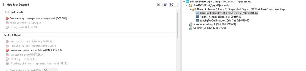

I'm trying to make a simple project consisting of STM32F750Z8T6 (taking instructions from QSPI), a 480x272 display (using LTDC), and a W9812G6KH-6I SDRAM (using FMC).
The project consists of a single screen representing an analog and a digital clock.
The project seems to work but suddenly a random hardfault occurs and I don't understand why.
Can anyone help me figure out what is the cause of the error?
Which settings did I set incorrectly
I share the project (Application + Booloader)

Hi all, thanks for support but I still have problems.
So I tried to enable one piece at time starting from a basic configuration: microcontroller and LCD.
I enable internal RAM for LCD buffer, QSPI for fetch instruction and I disabled Art accelerator, DMA2D, FMC, (FREERTOS is not enabled).. I loaded also an GUI example.

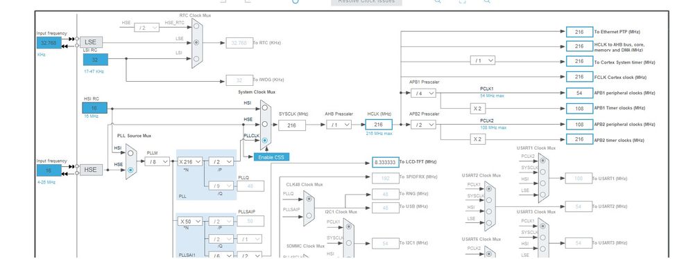

I think , clock is setted correctly:

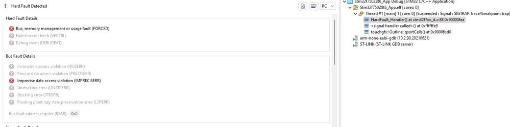

}But when the program is running I got always the same problem::
I haven't more ideas. maybe I didn't understand how stm32f750 works, but it seem impossible that this simple programs does not work.
Can Boot application settings blcok the APP execution?
Thanks

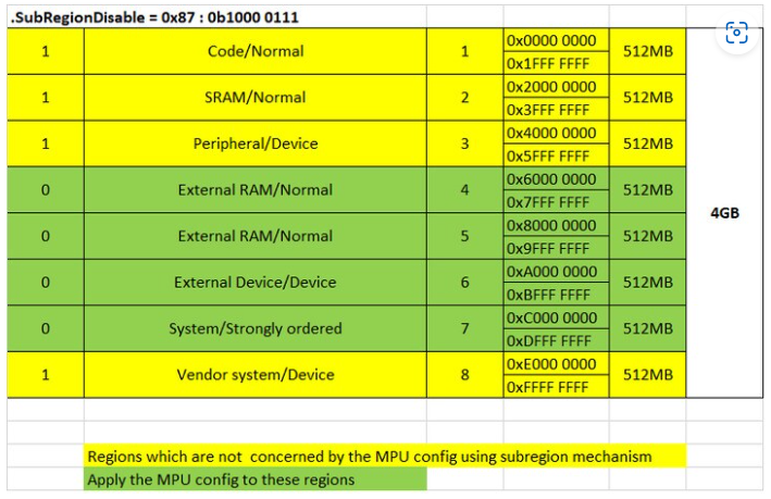

Your MPU configuration misses the most important region, the one that disables all accesses to external memories :
MPU_InitStruct.Enable = MPU_REGION_ENABLE;
MPU_InitStruct.BaseAddress = 0x00;
MPU_InitStruct.Size = MPU_REGION_SIZE_4GB;
MPU_InitStruct.AccessPermission = MPU_REGION_NO_ACCESS;
MPU_InitStruct.IsBufferable = MPU_ACCESS_NOT_BUFFERABLE;
MPU_InitStruct.IsCacheable = MPU_ACCESS_NOT_CACHEABLE;
MPU_InitStruct.IsShareable = MPU_ACCESS_SHAREABLE;
MPU_InitStruct.Number = MPU_REGION_NUMBER0;
MPU_InitStruct.TypeExtField = MPU_TEX_LEVEL0;
MPU_InitStruct.SubRegionDisable = 0x87;
MPU_InitStruct.DisableExec = MPU_INSTRUCTION_ACCESS_DISABLE;
The External RAM memory region is critical, since it is by default Normal memory type and executable and Cortex®-M7 may perform speculative reads to this area, even when there is no memory connected.
The recommendation is to create a safe background region, where the default attributes of the External RAM memory region will be changed (no speculative access allowed).
So, this MPU config makes 4GB not accessible except subregions set to 1 in MPU_InitStruct.SubRegionDisable structure member.
.SubRegionDisable means disable current MPU config for subregions set to 1.
In a given MPU region, there are 8 subregions. So if you divide 4GB (in this case) by 8 you will find 512MB. If you look at memory mapping of default MPU of ARM (4G), you can notice, there are 8 address ranges of 512MB.
There are 4 subregions (of 512M) targeted by this default MPU config in the range: 0x6000 0000 to 0xDFFF FFFF which corresponds to external memories range (FMC, QSPI, OSPI etc ..).
In the above MPU config, each subregion has a size of 512M. MPU_InitStruct.SubRegionDisable = 0x87, will prevent regions in yellow to being set by this config. These regions still in their default MPU config.
SubRegionDisable = 0x87 : 0b1000 0111 --> each bit set to 1 means: don't apply the current MPU config to that subregion.
Please try again with this region defined as MPU_REGION_NUMBER0 then change the region number of the other regions you defined for QSPI and QSPI control registers.

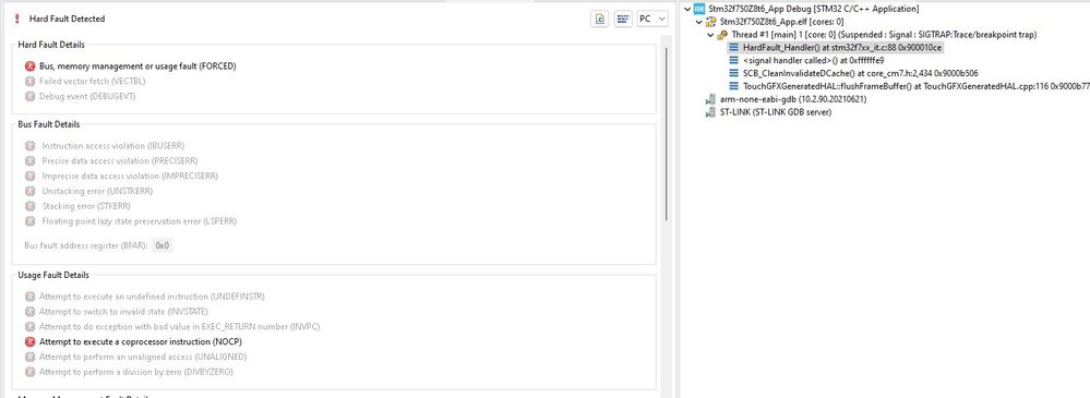

}Respect the previous settings, the actual code block itselft after some minutes than some seconds of prevoius code.
I tried to enabled DMA2D accelerator on touchgfx settings and on CortexM7, changing tye of Flash interface to TCM and enbleing ART Accelerator.
But these changes doesn't solve.
(I remember you that I have only LTCD, QSPI , internal RAM and the project use External BOOT + APP. I'm using ST "gauge example" for my User interface).
What others settings are missing or can be wrong?
Thanks in advance.
