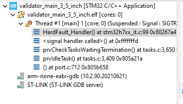

I'm working on a FREERTOS based STM32H7A3 application.

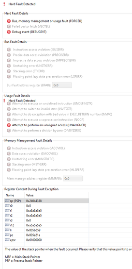

Upon debugging, my code randomly halts on UNALIGNED hardfault. The occurrence of this fault condition is very rare. During my testing in the last 30days, I ran into this for nearly 3 times with no clue of the source of this fault.
Attaching some screenshots from the last debug session.
Call Stack
Fault Analyzer

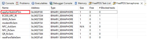

FreeRTOS Semaphores
I also noticed some unwanted characters present at the end of Semaphore name. It must be "appSysTaskInit" (Marked in Red).
