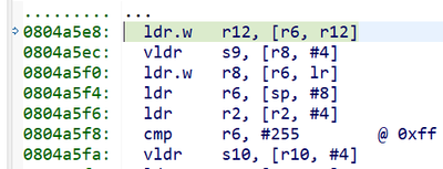

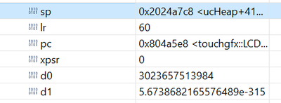

When I debugged further, I saw like this in the debugger.
Disassembly hit in this command:

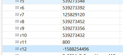

When I checked the registers r6 and r12, r12 seems to be an invalid memory location:
