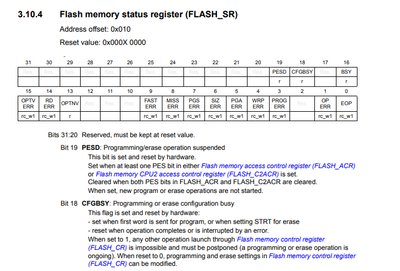

From the reference manual (RM0434 - Section 3.10.5 FLASH_CR) for the STM32WB I see that
"This register (FLASH_CR) must not be modified when CFGBSY in Flash memory status register
(FLASH_SR) is set. This would result in... a bus error, if CFGBSY is set due to a double-word programming sequence and the write to FLASH_CR is performed after the first word is sent for programming and before
the second."

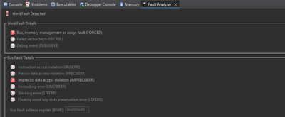

The hardfault I receive is a bus error

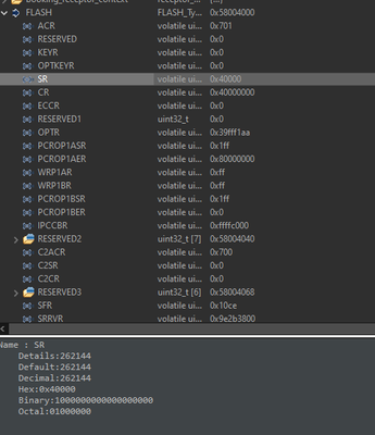

Further, when I inspect the CFGBSY bit in the FLASH_SR register I find that it is set
So I figure the fault occurs because the program tries to modify the FLASH_CR register when the CFGBSY bit is set in the HAL_FLASH_Lock( ) function

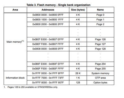

The specific pages of flash that I am modifying (erasing) are 167 - 170. According to the memory map for the STM32WB55 this is okay

Thank you for your response, I believe the problem was caused by me overwritting some memory with memcpy() somewhere else hence the IMPRECISERR. I will keep in mind to check the error code next time this happens.
