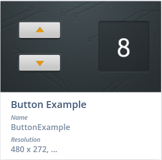

Using a STM32F746G-Discovery board and TouchGFX 4.20.0, the on-screen buttons of the "Button example" as distributed with the TouchGFX package do not respond after the board is reset via the reset button or on a power-up reset. When flashing the code and the ST-Link debugger resets the processor, it works fine, as well as when the processor is reset with STM32CubeProgrammer. Also works as expected under debugger control.

This "button example" you are referring to is the "button example" available in TouchGFX Designer right ? Or is it from some sort of Out of the Box package ? Did you face a similar bug with other demos/examples available in TouchGFX Designer ?
