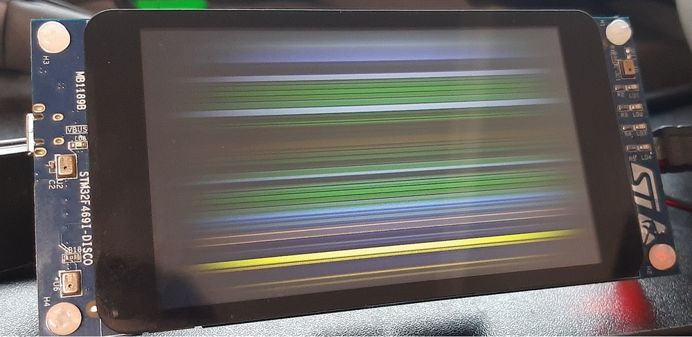

And here example what I can see on the LCD

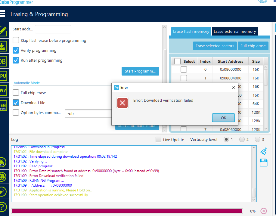

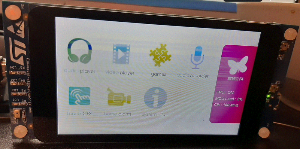

Then I'm taking compiled demo binaries from official page and program it using STM32CubeProgrammer
If I leave board without power for some time, 10 - 15 mins, this white lines gone and image became good. But this not work with examples - they didn't work after board "rest".
Also tried to program binaries compiled by STM32CubeIDE with STM32CubeProgrammer - the same but with some verification errors.
And official demo binaries also says verification errors.
Is it some hardware issue on my board and I need new one?
Any ideas?
2022-02-21 8:16 AM
Your board equip too external QSPI memory and you need manage it.
Error on image is about it.

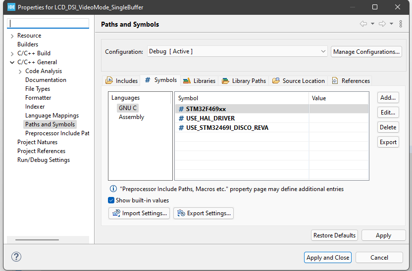

Hello.
Change project settings: [c/c++]>[patch and symbols]>[symbols]
delete USE_STM32469I_DISCO_REVC
add USE_STM32469I_DISCO_REVA
2022-03-03 12:23 PM
like this :)
