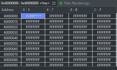

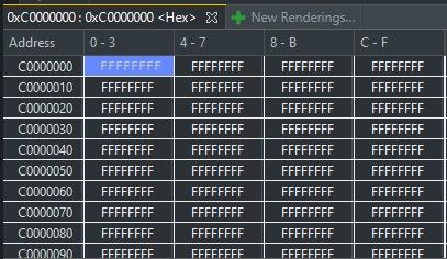

2022-09-02 3:11 AM
When remap is the default so base address is 0x6000000, it only wrote data to the first memory group when I called HAL_EnableFMCMemorySwapping ();
and changed the address to 0xC0000000 Nothing is typed into the cells. I have no idea why that is
